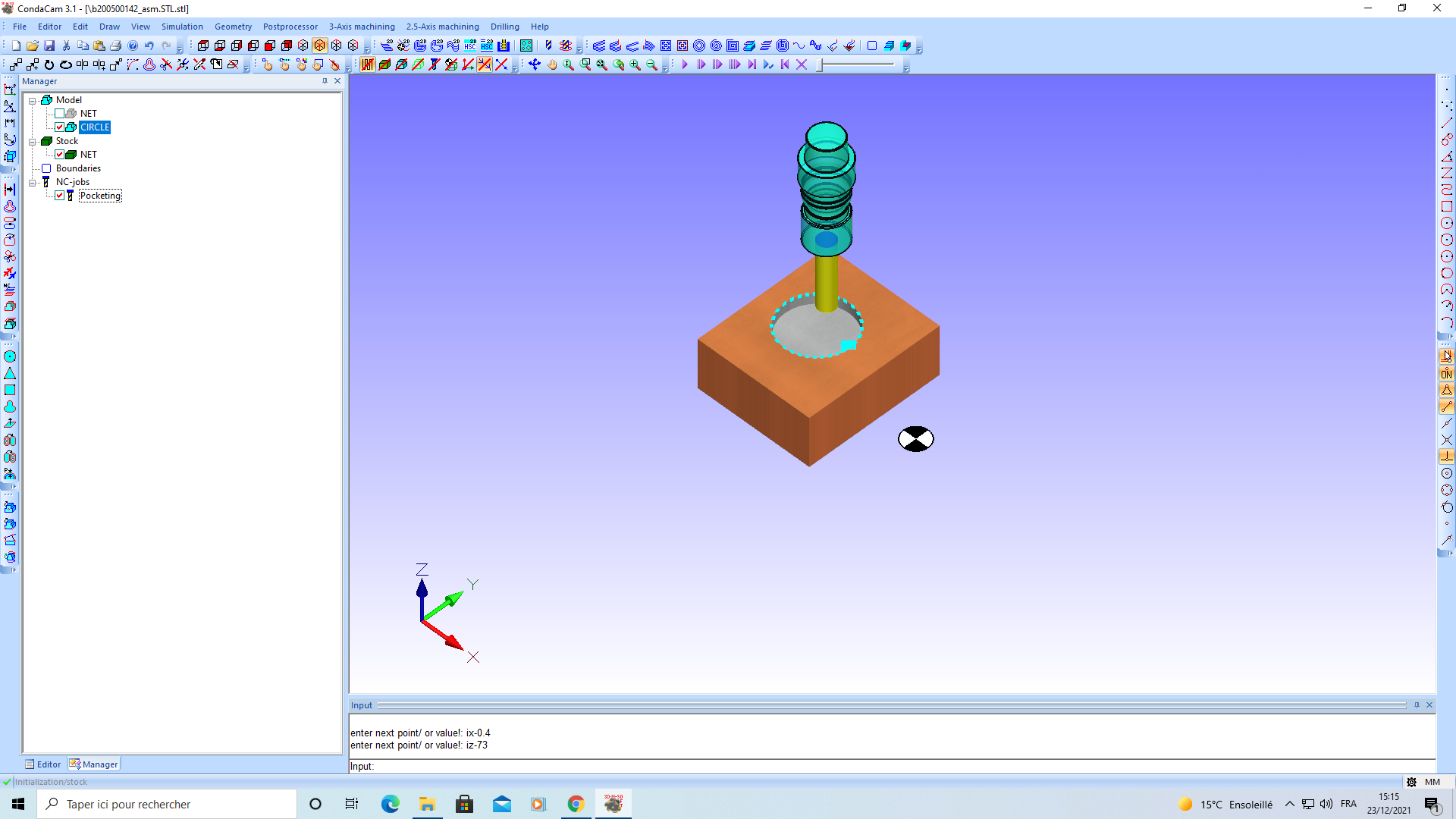

hi team condacam
i will to know how import the vice correctly ,i import the the step by i have problèm with the zeropoint , he change by itself
thank you

Re: vice
Post by SUPPORT » 24.01.2022, 16:00
Oh Sorry!
In the default the zeropoint is positioned in dependence to one of the corners of the Boundary box.
By this the component can be moved and the zeropoint maintains its position. Simultaneously
the measures describe a shift starting from one of the selected corners.
Should the zeropoint have an independed position in the drawing that are defined by drawing coordinates
the option "global coordinate system" is to activate.
Be careful with the Selection!
The zero point can also be positioned in the drawing with the function Move...
Best regards...

tanks for your help, i have a question for after import the vice i cannot selected just the jaw for adjust at the stock
thanks

Post by SUPPORT » 08.02.2022, 10:10
Hello, one STL file can not manage multiple bodies. but you could import two STL files. So import the vise jaw separately from the vise.
best regards...
