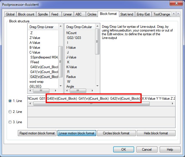

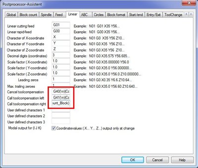

Re: radius compensation "G40" - "G42"
Hello,
This is very simple.
Open the post processor in the post processor assistant (Menu=>"Postprocessor"=>"Create postprocessor").
In the post processor assistant on the tab "Linear" you need
to replace the macros G40, G41, G42 with following macros (s. image)
G40(\n)(Count_Block)
G41(\n)(Count_Block)
G42(\n)(Count_Block) The macro (\n) creates a new line behind the call "G40". In order that the new line
contains a block number you still need the macro (Count_Block).
control then on the tab "Block format => tab "Linear motion block format" whether the macros will be visible(behind "NCount"), if not drag the macros to the begin of the line behind the
position "NCount" (as seen in the image). Best regards, your Condacam team
